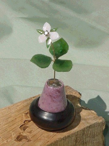

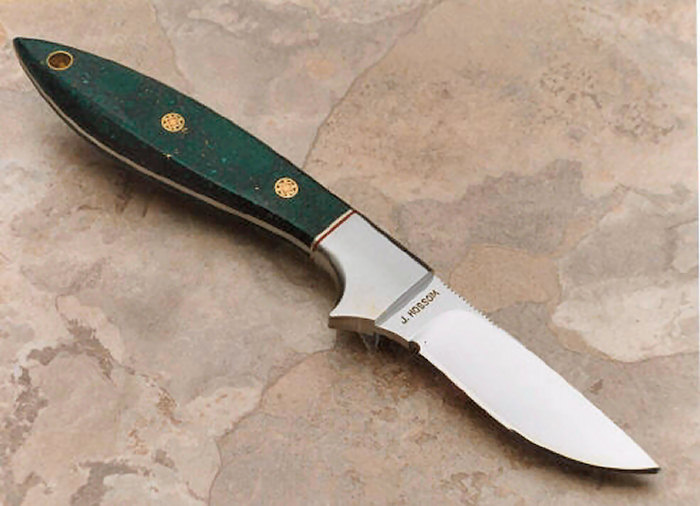

Jerry, I've always wanted a jade handled knife. If you supply the blade, I'll make the handle. Is it a deal?

Nice work, Steve. I did a jade one once. It's old. I haven't used this mark in about 5 years.

[QUOTE=Jerry Hossom] Nice work, Steve. I did a jade one once. It's old. I haven't used this mark in about 5 years.
Beautiful stuff, Jerry. What do you do about sheaths for these? Sheaths 'r us?
